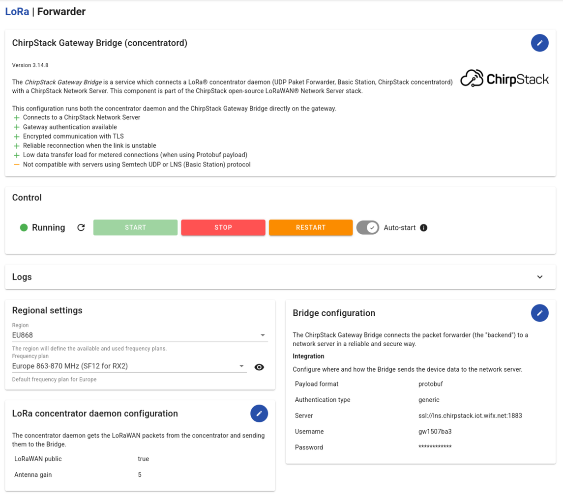

Setup
Please refer to the ChirStack page in the LORIX OS documentation for more information.
ChirpStack Gateway Bridge configuration page in LORIX OS
